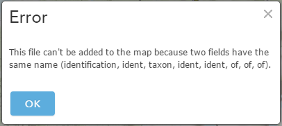

I have tried adding the CSV version as a web layer, however this returns the following error, which I suspect might be because there are spaces in some of the column names.:
Does anyone know a way of getting the JSON feed from the iNat API into ArcGIS Online as a layer?
