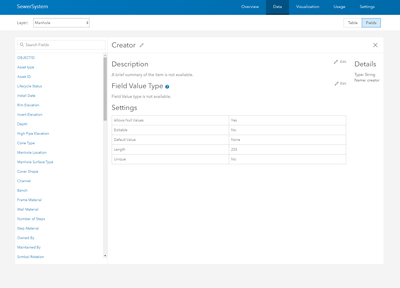

Send screenshots of what you see for that field.
irector_tlg
As you can see, there is no place to add a new list.

The Creator field you are showing is a for editor tracking so a list cannot be added to that field. Can you create a list for a field such as the Notes field?
