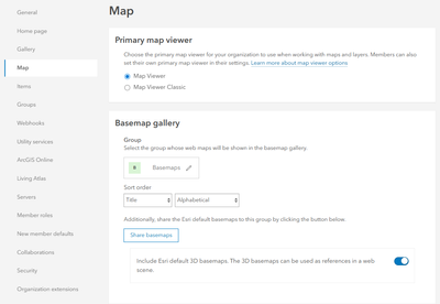

I've solved my own problem. I'll post it here in case anyone else needs this solution in the future. It was a very straightforward fix, but one I wasn't familiar with. Once you have created a map with the azure imagery as a base map layer that map should be added to a group within AGOL. The group can then be set as the Basemap Gallery group within the Organization > Settings within the Map section. There's even an option to include ESRI default basemaps as part of the same group.
