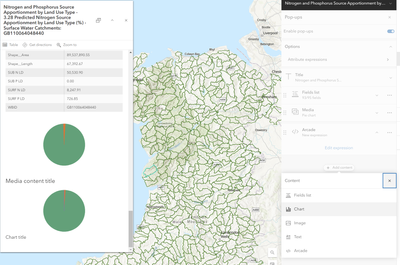

How to add a pie chart to a pop-up using an Arcade expression
1474
07-09-2024 01:27 AM
Labels (2)
OliverIshmael
I would like to add a pie chart to a popup on a map (using the new map viewer). My data looks like this: Nitrogen and Phosphorus Source Apportionment by Land Use Type - Data (arcgis.com)
I have no experience of using Arcade and most examples i can find online make use of JavaScript, which i also don't know. I found an example somewhere that i used as a template (see below) , but this doesn't seem to work on it's own:

 Can anyone tell me what else i need to add to make this work?
OliverIshmael
The issue for us appears to be that the following line was omitted. Once added to the top of the script it worked:
Expects($feature, '*');
JohnEvans6
I just pasted that in and it worked out of the box. Did you also try adding media -> chart via the map?
OliverIshmael
