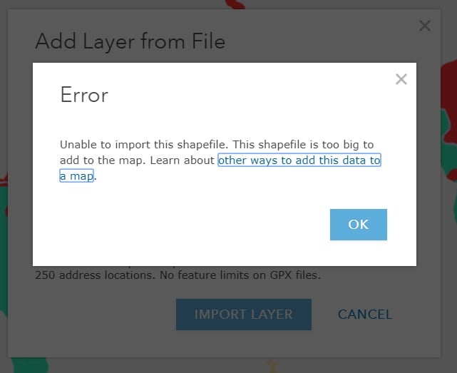

I had a shapefile with information about wetlands, but this was so big (170 Mb). After that I used "Dissolve" for decrease the number of features, "Generalize" for decrease the number of vertex, I exported differents shapefiles according atributes. After this, I have a lot of shapefiles, all of this have less than 10 Mb (150 Kb - 7Mb) but I can't upload. Show this:
Some suggestion for this problem? I need make a map in ArcGIS Online for a Story Maps and I can't access to ArcGIS Server

After downloading your data I see there are only 8 features but that these are very large and complex. 5 of the 8 features also have geometry issues (self intersections) that I found with the check geometry tool in Pro. However, even after the geometry issues were repaired it still failed to upload directly to map viewer so the issue is likely with an excessive number of vertices. I ran the feature vertices to points tool in Pro and there are close to 280,000 vertices in this shapefile.
I was able to publish the data as a hosted feature layer when I signed in with an organizational account.

Due to the size of the file it would have to be created as a hosted feature layer which you are correct cannot be done with a public account. As a work around for your public account you could break the file up into subsets and add it directly to the web map viewer.
KatyaDiaz
Hi Katie,
Well... The file that uploaded have an excessive number of vertices, I generalized the file (20 meters of tolerance) and for this, have self intersections (I don't repair this after).
My option now is use an organizational account for publish this information...
