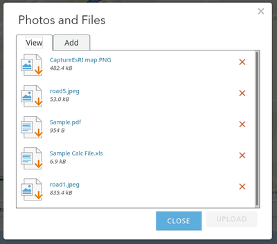

I'm trying to figure out how to view the exifInfo data after I fetch the attachments from ArcGIS JavaScript.   I added attachments to the feature and I know road1 and road5 have exif data:

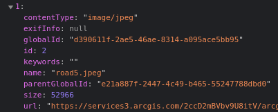

When I fetch the data I get this object back:
How do I enable the exifInfo?  I was reading about a flag that I have to turn on in the settings of the feature layer but I can't see or find any option for this.
