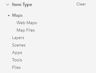

While in a group page, you can select the item type to filter on (maps, apps, layers, etc...).  Is it possible to to select multiple types for your filter?  I'd like to be able to view Apps and Maps at the same time.  I tried formatting the link to include 'focus=maps&focus=apps', but it just returns all items in the group.
Selecting the Maps filter formats the link like this:
[XX/home/group.html?id=65e50fc1fc9548d783cb95cbebfb724a&view=list&sortOrder=asc&sortField=title&focus=maps#content]
I tried this and it didn't work:
[XX/home/group.html?id=65e50fc1fc9548d783cb95cbebfb724a&view=list&sortOrder=asc&sortField=title&focus=maps&focus=apps#content]
Any help would be much appreciated!
-David

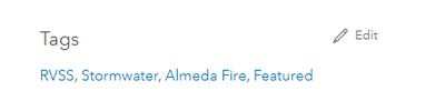

Ok thanks Josh!  It's working by adding the search term to the tags of the items I want to come up, in this case "featured" : )
**Edit -- that sort of worked, except now I'm getting all items including layers, which I don't want to display.  I ended up just categorizing the ones I wanted, and using that link after applying the category filter on my website to jump to the "See more apps" page.
