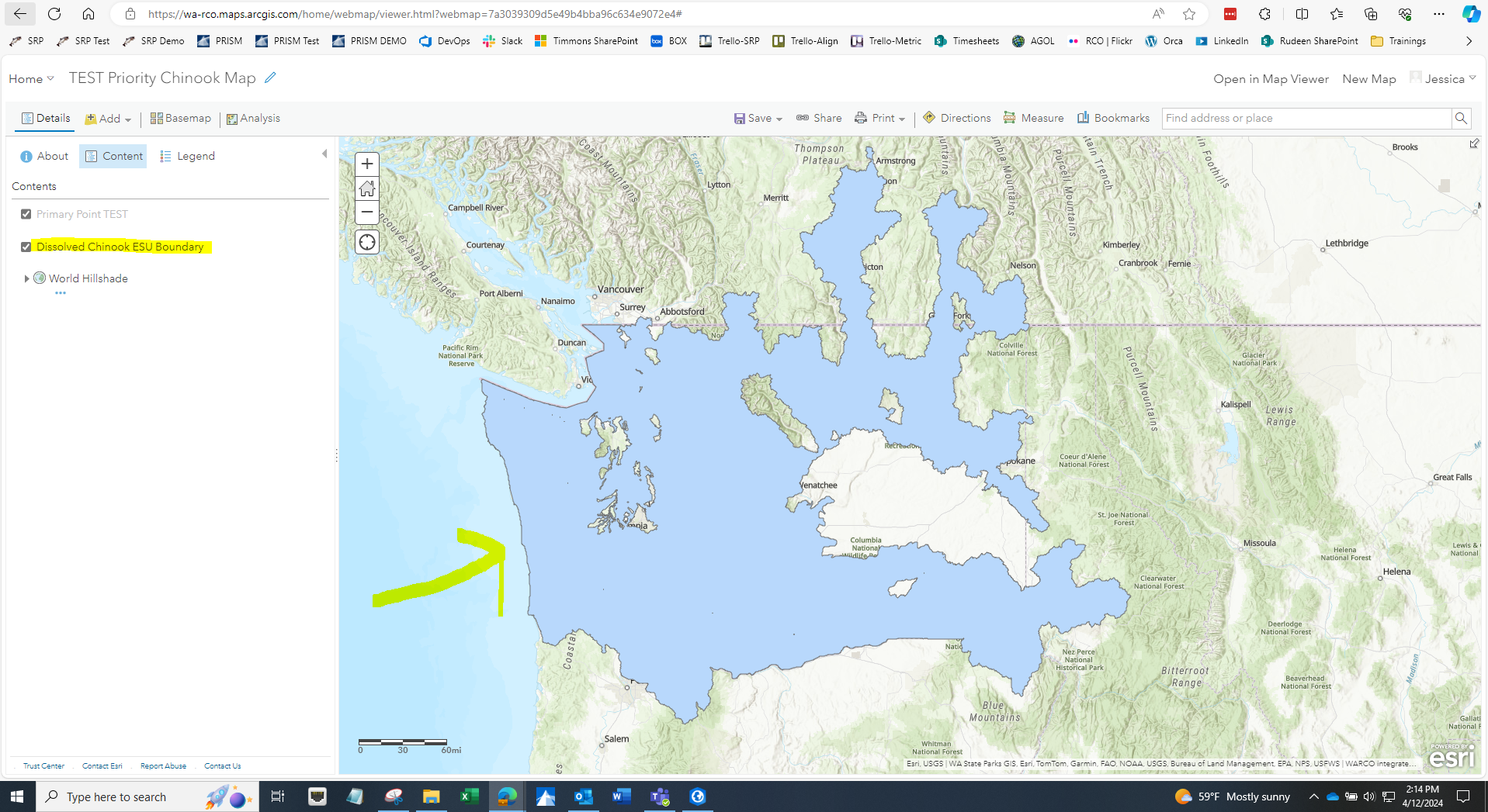

The current polygon layer (blue):

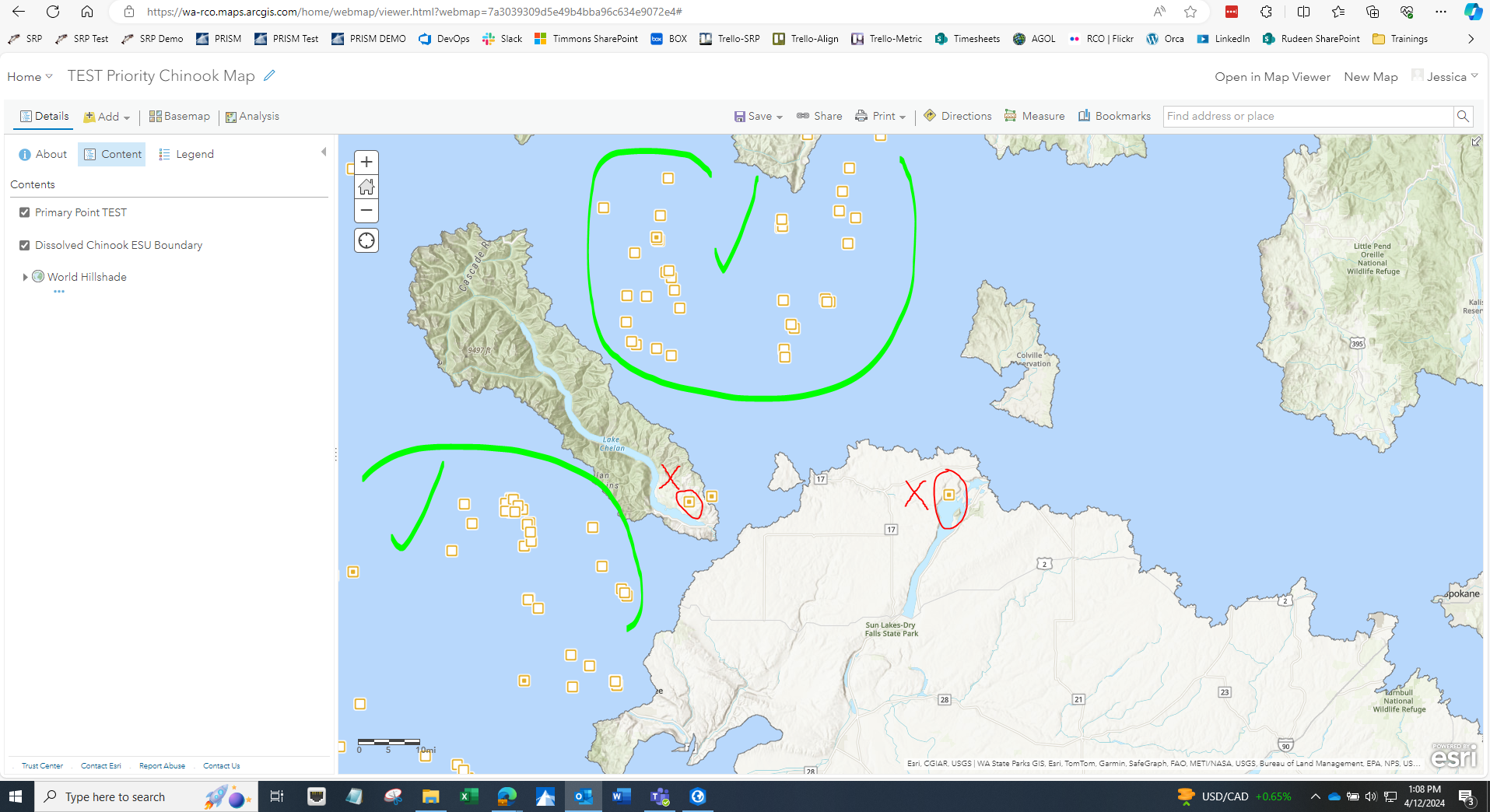

Example of points we would want on the map (highlighted green with check mark) and those we don't want to show on the map (flagged red with 'x').

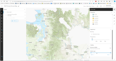

I tried with Destination In and still no luck. Here is what I see:
