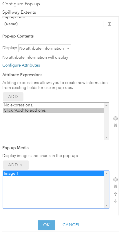

I am hoping to display images in the pop up media for my feature class in the webmap I have created, with separate images for each attribute. So far I can display an image but it is the same one for all the features in the entire feature class e.g. I have 3 features in 3 different locations on my map - I want to show different images for each one, but I can only show the same one for all of them at the moment.
Would anybody know how I can get around this?
Below is a screen shot of the configure attribute window - Is an attribute expression required to achieve what I'm after?
Any assistance would be much appreciated!
Cheers
Andrew

You would need to have a field in the attribute table hold the image name you want attached to the feature. In one dataset, I have a field (Site_ID) that contains the image taken at a site. The name of the image has the Site_ID as its name. Here is how I have configured the image dialog for the popup

Thanks for your response Ken. Do you mean your SITEID field in the attribute table holds just a text string of the image name or a path to the actual image?

In this case, the Site_ID field contains just a string.
The images are stored in the directory as 2016_0.jpg, 2016_4.jpg,2016_6.jpg, etc. The rest of the path is built from the content in the URL portion of the configuration dialog in my previous post.
If you have the entire url of the image stored in the field, your configuration dialog would look like this
