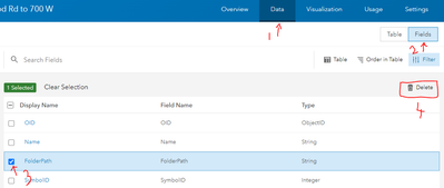

In your item details, go to Data (1). Then click on Fields (2). Click the check box (3) next to the field. Then a Delete button (4) will appear.

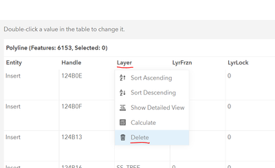

@sr_guy if you have rights to edit the layer (ie if you published it to AGOL from the GIS data), then you should be able to delete a field by clicking on the field name and selecting DELETE
eg

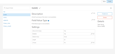

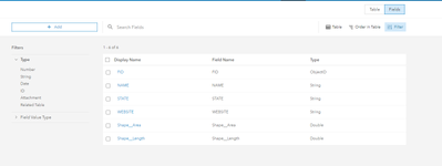

This is what I am seeing on this end...
1.) First click on Fields
2.) Clicking on name
I hid a ton of fields so they do not populate, but i wouldn't think that would cause an issue with deleting single entries in the database. Obviously, I can edit all those fields, and even add new ones, but why a delete field option isn't present perplexes me.

What does that big red Delete button do if you click on it?
sr_guy
I want to delete individual power company fields in the DB, not the entire Name column.
