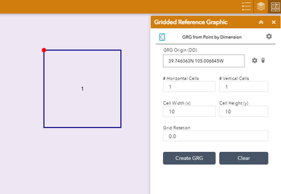

Hi @RyanBohan , in ArcGIS Online this functionality is currently available in Web AppBuilder using the Gridded Reference Graphic widget. You can customize the size of the grids and how they are generated, and save the result to a target hosted feature layer.
If this is functionality you require in the newer apps and editors (e.g. Experience Builder), please log a new ArcGIS Online idea.

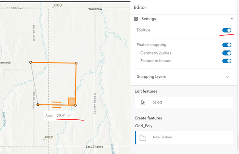

@RyanBohan , another option I just recalled would be using the Editor widget (from Map Viewer or the Sidebar Instant App template, or Experience Builder), and using the Tooltips you will be able to see the area for the square you are drawing (area for polygons and distance of you use lines).
But yes, a simple square "stamp" would be a lot easier...
