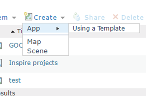

I do not currently have the option of using Web App Builder in my AGOL account, there is only the option for creating a web app from template.  I read online that you must be a "level 2" user in order to access WAB.  Does anyone have suggestions to access WAB? or did AGOL change something?  You can see the option is not available as see in all examples online.

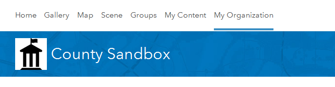

The 'My Organization' will appear when you are signed into www.arcgis.com.  Ex:
It sounds like you are using ArcGIS Online (Personal Account), which will not have this tab.  You will need to activate your ArcGIS Online (Organization Account).  Since you have a Desktop license, you are entitled to an Organization Account.  You can call customer service at 888-377-4575 and they will e-mail you the activation link.
