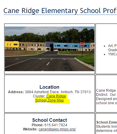

NathanWood2
here is a look at school page with highlighted links for old pdf maps.
