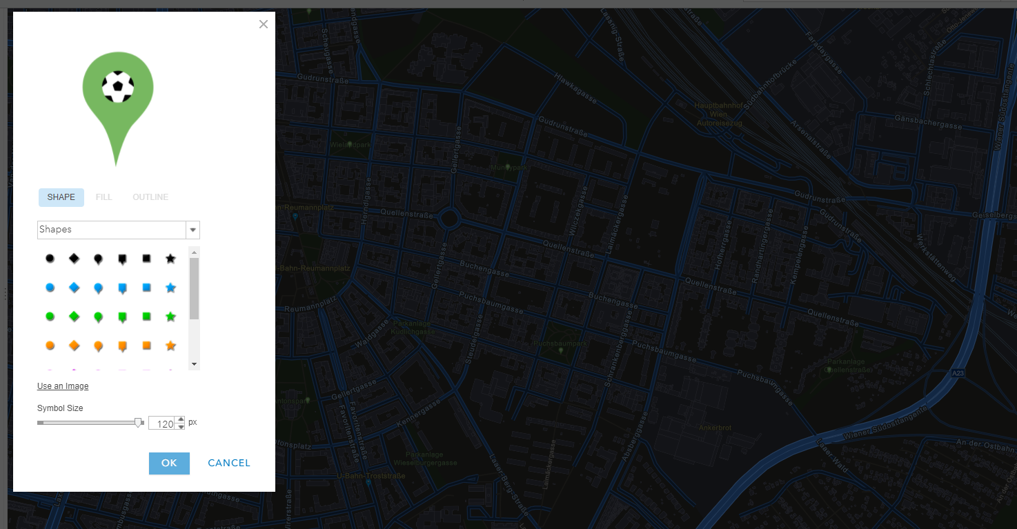

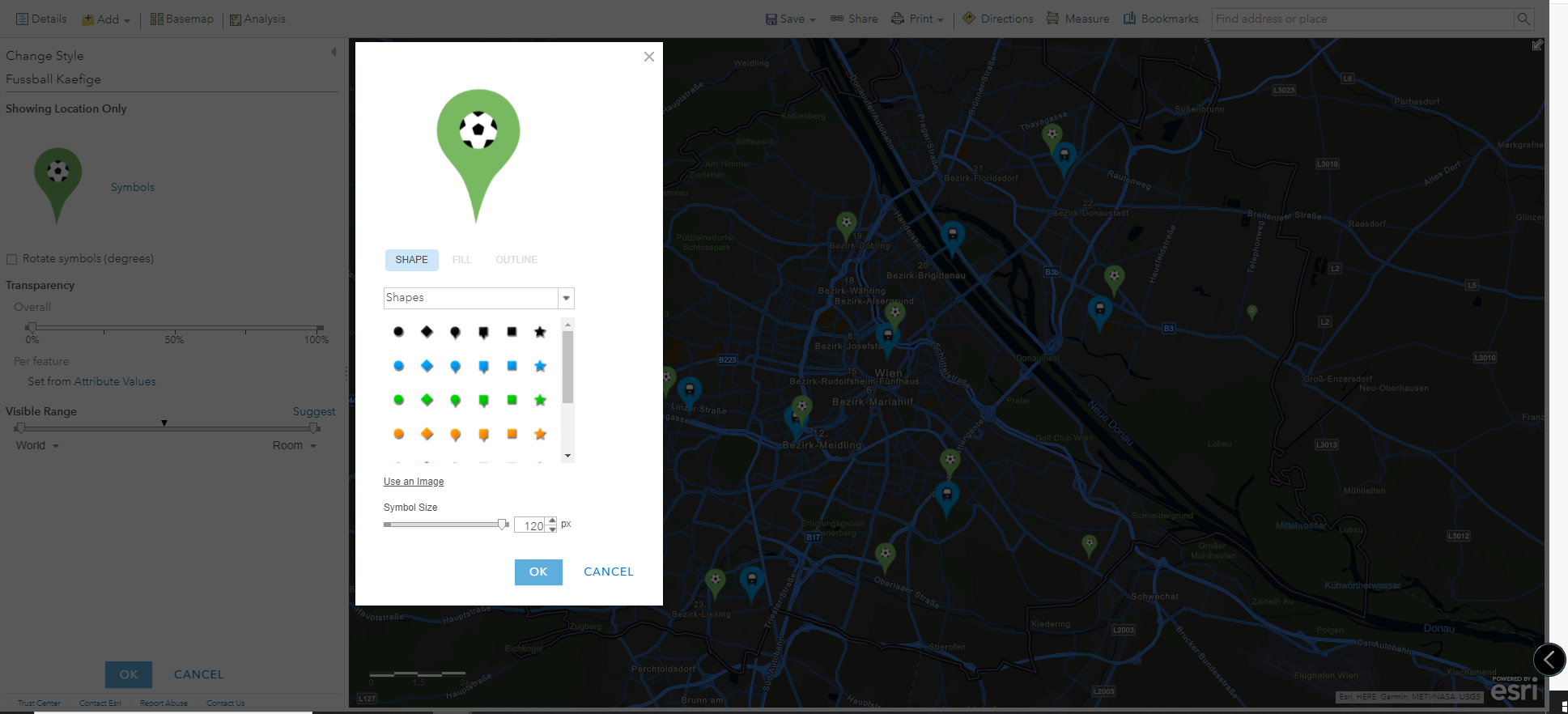

Hello I created a webmap in ArcGIS Pro and shared it with ArcGIS Online. I clustered the symbols of my features, but now they are really small after zooming in. Even with the maximum Symbol Size they are a way to small.
Does someone know how to change it?
Thx in advance.
First picture is before zooming in (symbols big enough)
Second is after zooming in (symbols too small)

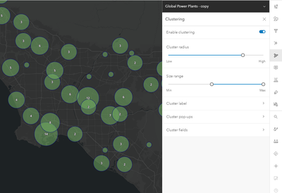

In the New Map Viewer you can adjust the sizing of the clusters using the size slider. You can see the clusters have the cluster number present and the none clustered features have no number present.

Thank you it worked, but now it doesn't zoom in smoothly anymore, its actually really laggy. Does this mean I have to use caching?
