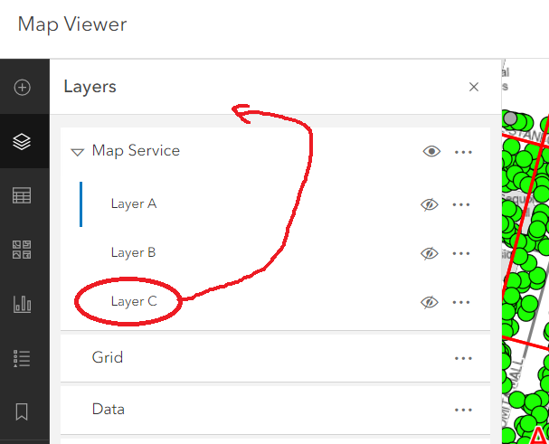

I have a Map Service (published from our on-prem ArcGIS Server and host the layer in AGOL), How can I add a MAP SERVICE sub-layer to Web Viewer?
(In the Web Map Classic Version, after i added a Map Service, i can get the URL of the sub-layer and add the sub-layer URL directly, but it doesn't work for the New Map Viewer)

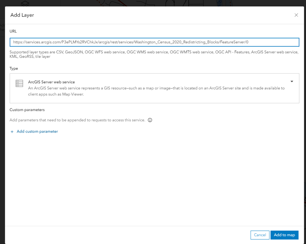

You can add the URL directly by clicking Add and selection Add layer from URL
This brings up the Add layer dialog, which accepts the sub-layer URL

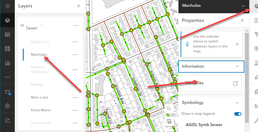

Select the sub-layer you want.  Upper right, click Properties, expand "Information", then click on the layer name.  This will take you to the REST endpoint of the sub-layer.
