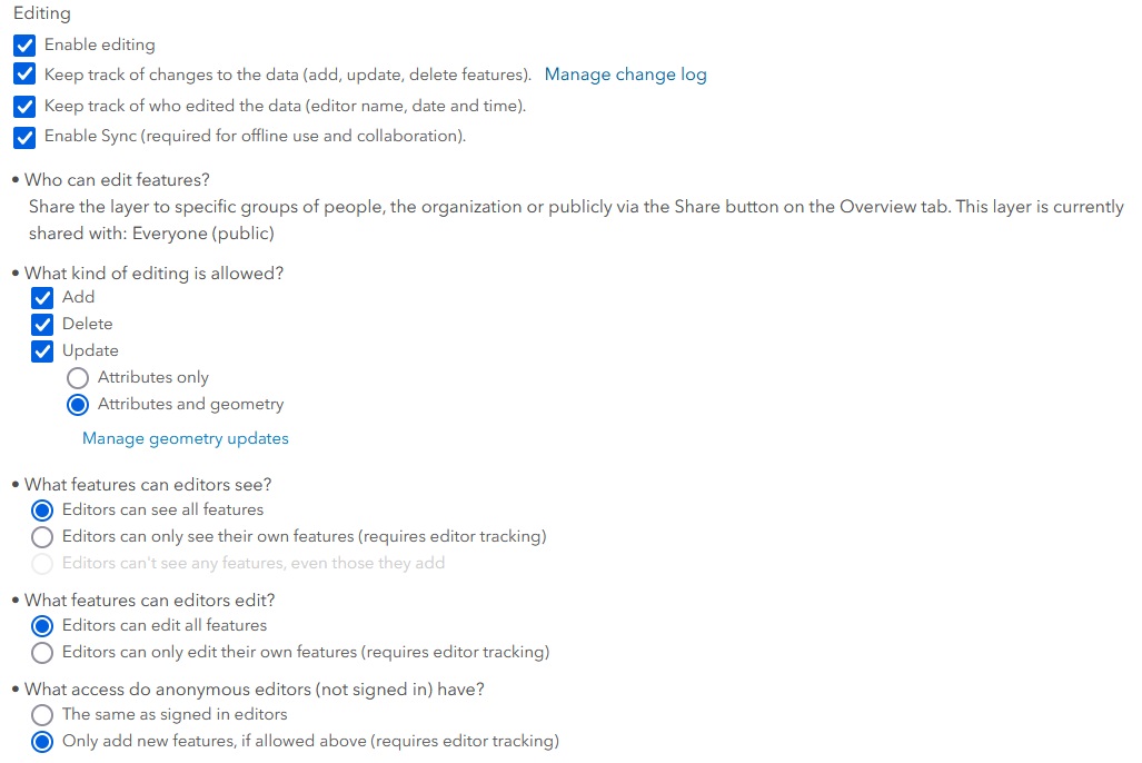

I have a hosted feature layer that is shared with Everyone(public).  I have set all the settings so that editing is completely allowed for anybody who is signed in.  Why can't another member of my organization (signed in) edit points in the layer?
If I open the layer in Map Viewer and click on a point, I get a pop-up window that includes an Edit button.  I can use that Edit button to delete the point.  However, if my colleague opens it and clicks on a point, her pop-up window does not include an Edit button.
Here is a screen shot of the Settings for the feature layer:
BenjamenWetherill
ESRI support helped me solve this issue.  I needed to Enable Editing in the Web Map properties.  See screen shot.

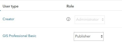

Can you send a pic of the user type?
BenjamenWetherill
Here are our two user types.  I am the first one and my colleague is the second
