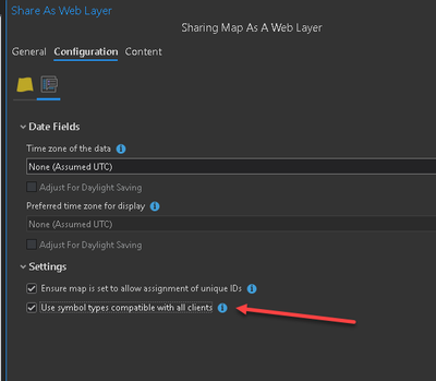

If shared from Pro, did you enable the compatible with all clients option so that the Classic version can utilize them as well?

Indeed, I shared from Pro, but I didn't have the "compatible with all clients" option enabled.
Much better now... it is displayed correctly. (In fact, the map and app were created quite a while ago, using the old Map Viewer - now Classic - and Web App Builder.)
