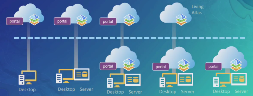

Can you tell a little more on your organization? How large is it, what's the core business? The database you are working on, what do you have so far (data, hardware and software) and what would you like to include in this database? If you are just starting it might be difficult to get the budget and infrastructure to implement ArcGIS Enterprise. As a side note, "Portal for ArcGIS" was a product in previous release, it is now part of ArcGIS Enterprise which you either install on-premises in your infrastructure or role out in the cloud.
Maybe it is wise to start with a combination of Desktop (ArcGIS Pro, see ArcGIS Pro | Professional 2D & 3D GIS Mapping Software ) and ArcGIS Online (see: ArcGIS Online ) to start with. See below different implementations:
This image was extracted from the presentation: ArcGIS Online Steps For Success: A Best Practices Approach - YouTube
Each implementation serves a specific need, it is best to contact your local distributor and let them advise you on what is best in your case.
