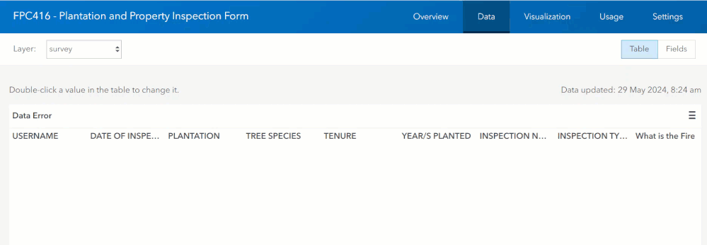

Can anyone suggest how to fix this? Or is republish the only option? Tab ever so briefly loads the records then changes to show "Data error" with no records. The feature service was initially published as part of a Survey123 survey.

Found out the problem. The Survey contained fields with "-" in the name (typically all spaces were dealt with "_" but this was a genuine hyphen case that hadn't also been swapped for underscores. Replaced the hyphens with underscores and republished and it all worked.
It was strange how Survey123 didn't flag it as an issue though when analysing the survey prior to publishing. Something as obvious as incorrect field name formatting should be a basic check.

There's a known issue for this - BUG-000158590
  • Synopsis: Unable to display attribute table while accessing feature layer generated from ArcGIS Survey123 in both map viewer and map viewer classic.
Users suggest a workaround of changing editor settings so that users can 'see all features' under 'what features can editors see?'

Thanks for pointing that out! That is a bit frustrating, but at least a simple fix....or at least I hoped it would be! I've updated the setting however, I still get the same error. In addition to the previouis GIF example, I can see the points in the map but can't select them (despite being an administrator).

The workaround was meant to be 'editors can see all features', if you'd had the settings shown and had the error.
I'm not aware of any other workarounds.

Yep. Thats the setting I changed (screenshot was in the "before" state). I've logged this with Esri Support. I've gone through the survey xlsx with a fine tooth comb, fixed all warnings and errors and made sure it's the latest version with no joy. See if they can figure it out!

Survey123 XLSForm has data validation in the Name column that will flag this. It shouldn't make it to the Analyze stage.
If you're pasting values in it will override the formatting and data validation. Make sure you're right-clicking and selecting 'paste values only' in Excel. Keep an eye out for green triangles or red highlights.
Alarm bells always go off when I see an XLSForm with a mix of fonts and formatting in Excel. It suggests the data validation has been removed and that the survey may have underlying errors not being correctly flagged and addressed.
