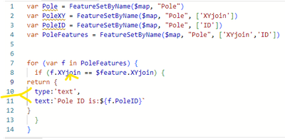

I keep getting errors and I have a tough time understanding the syntax fully.  I’m not sure what I have wrong.  I've tried a bunch of different iterations, but below is the current iteration that I have.  The portions marked with yellow I’m not fully following what they represent and where those pieces are being pulled from.
What does f.XYjoin represent on line 8?
What do lines 10 & 11 represent/where is f.PoleID pulled from/represent?

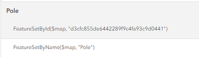

Pole layer fields and info are being pulled from the $map feature service (see below)

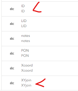

The ID field marked below is the pole layer’s ID field from which I want to pull an attribute and insert into the pole_id field in the Riser layer based on the pole layer’s XYjoin field attribute matching the Riser layer’s XYjoin field attribute
Again, apologies for the repeated questions, and I appreciate if/when you’re able to provide any help & feedback.

Get rid of your first 3 variables and just use PoleFeatures.
f is just variable that holds the data from each feature within PoleFeatres
${f.PoleID} should just be ${f.ID}, sorry. Hard to work with data I can't see.
If you put a Console(f) above the if statement, it will print out each feature within PoleFeatures as it iterates. You're sure the XYjoin field will match between the two data sets, yeah?

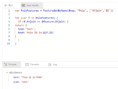

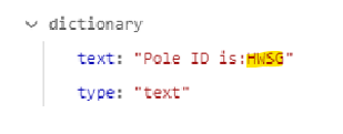

Hi @JohnEvans6 , I think we're close?  I adjusted based on your feedback and below is what came back:
I also confirmed that the XY values match in both layers for the specific features I used to test the code.

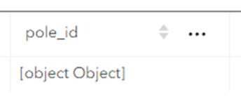

However, when I created the new Riser feature, below is what populated in the pole_id field for the Riser feature:
But what I want to populate is just the HSWG text, which is the pole feature's ID:
Sorry again for all the questions, and I appreciate all the feedback/help you've given!
