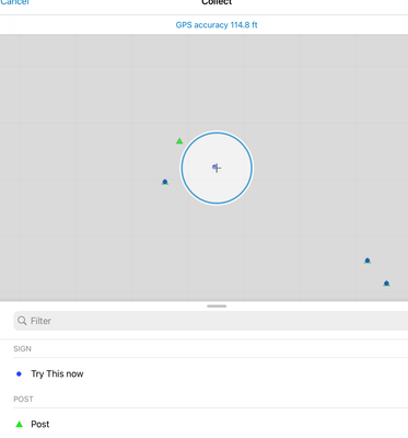

If I set up a form with a single template item (I have two layers here, both with single template item, Try This now and Post):

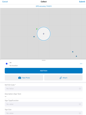

Then select one of the feature buttons, it will take me to the form for that layer (Try This now):

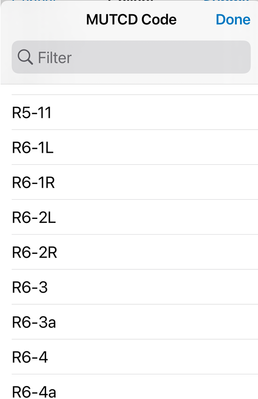

And lets me populate the form values and I have a Domain (pick list) for all the acceptable values for this field (I have a huge list, so either need to scroll to find the value I'm after or start typing in the 'Filter' box.  Will also show the most recently used values at the top of the list so no need to scroll/filter:

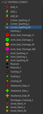

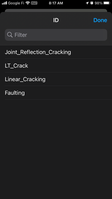

So I would like to have a basic collection screen without any scrolling similar to below, or just with the layer name and no symbology at all. Then after starting collection, use the identification of the distress to set the symbology of that point on the map with symbols like on the right picture.
Currently I can set it up with the symbology to collect all the data, but then field techs have to scroll through over 90 different symbols to find the desired distress. It isn't very efficient and would be making life more difficult for them, then using ArcPad.
