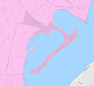

I was able to use Pro 2.6 to save and publish the hatching symbology to my web map in Portal using the new "Save Web Map" button:
However I also lose the color, it is only black in the web map. Yet, when I bring the web map back into Pro, it shows me the original color I published it as.
