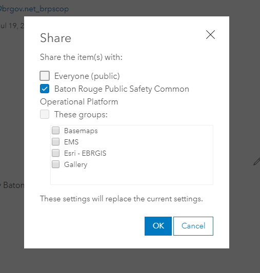

I have created some groups and shared them with my organization, invited members, and added some content.
When I'm trying to share through the Items Details page some of the groups are not available as options to share with.
Has anyone else run across this, or is there a step that I'm missing?

So these are the options I get...
Access -
Access and update capabilities -
And this is only for My Content and I have to take ownership of items to Share from my Contents page.

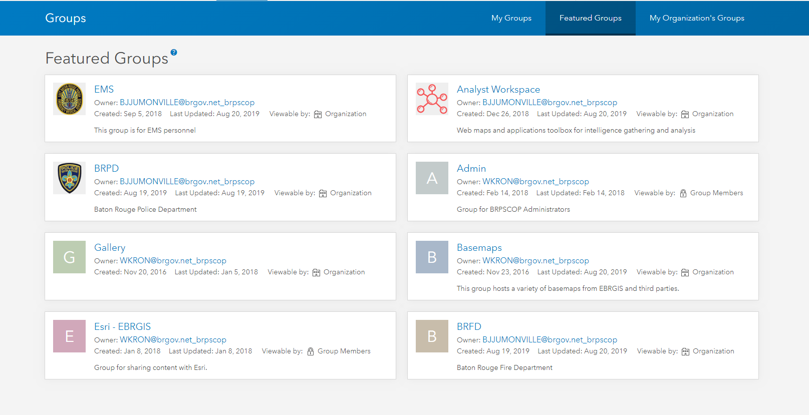

Well yes, I'd like to be able to do that.... but I need the groups to be able to be shared with.
EMS, Esri - EBRGIS, and Gallery are all available as groups to share with but not BRPD, BRFD, or Analyst Workspace.
I'm wondering how to have these groups show in the list as well.
Other users will be sharing with the groups as well.

Apologies if I'm getting a bit confused about what you're trying to do. As far as I understand, because the BRPD, BRFD and Analyst Workspace groups are the types of groups with Access and Update capabilities, they will not show up when trying to share through the item details page. Any user wanting to share with those groups will need to do it through My Content, or as an Administrator by managing a specific member's items. They will also obviously need to be member's of that group, assuming that's how you have them configured.
