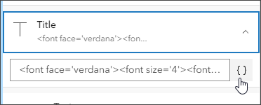

You can use a combination of HTML, expressions, and fields to custom tailor the pop-up title. For example, this map uses HTML to increase the size and change the color of the title, which also includes an expression.
https://www.maps.arcgis.com/apps/mapviewer/index.html?webmap=ced283616b0844988f2a249aa78eda45
The title is configured as follows:
font face='verdana'><font size='4'><font color='0066cc'>{expression/expr0}</font></font></font>
I think if you experiment a bit with fields and expressions, you should be able to get the desired results.
