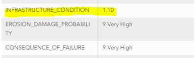

For some reason, the attribute pop up does not show floating number. For example, if the value is 1.10, it displays it as 1. Is there a way to fix this?

Hi @NazneenMushtaq ,
You should be able to configure the formatting for your numeric fields in Map Viewer via the Fields panel & Manage fields dialog. There you can set the number of decimal places that your numeric values display.
This blog can walk you through how to do it: https://www.esri.com/arcgis-blog/products/arcgis-online/mapping/batch-format-your-attributes-in-map-...

NazneenMushtaq
Hello @timcneil ,
Thank you so much for your help. I was able to fix it by following the instructions. I really appreciate your help
