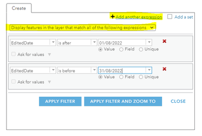

If using Map Viewer Classic, use the filter for the layer in the table of contents on the left and use the Add another expression option. Set toe Display features in the layer that match all of the following exprssions. Click Apply Filter

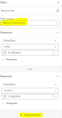

In new Map Viewer select the layer on the left and then use the Filter option on the right of the screen. Click Add expression options and in the Filter results drop down set to Match all expressions, click Save.
