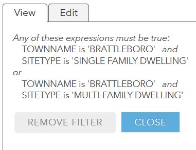

The reason the first one you tried didn't return any results is because it looks like it's set up as an "And" statement. You want to make sure that the word "or" shows up in the view. Example:
This is what the edit view looks like for that:
What does your edit view look like?
