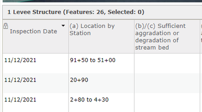

BrittanyBurson
Hi all, on Enterprise 10.8.1 and I feel like I am missing something here! Might be covid brain...

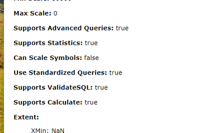

Our standardized SQL queries are enabled on my layer:
However I'm unable to get my date queries to work as expected. I'd like to show any points with a created_date (alias: Inspection Date) in the last 30 days.
I have two test events created today, 1/3/2021, that I am trying to verify are included in the filter.

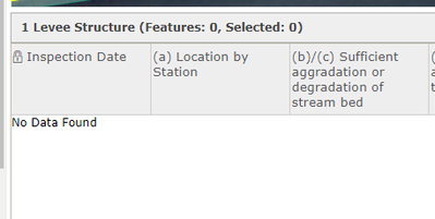

If I try "in the last 30 day(s)" I get no records:
If I try "in the last 2 month(s)" I get my events from November, but not today.
It doesn't seem like there is a combination I can try that successfully includes this month's records. Is it because of the year tick over? Any tips? My field crews are headed out next week and I'd like to have this resolved... hoping it's an easy overlook. Thank you!
