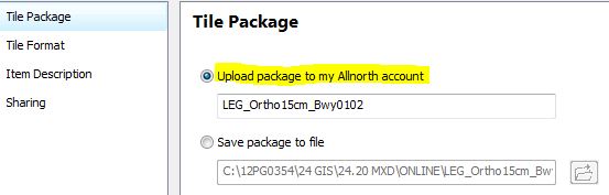

Hi Chris,
Thanks for the response.  I would suggest you issue a warning instead of completely cutting off uploads that even slightly exceed 1GB, the package in question that I tried to upload is 982 MB (1,030,377,472 bytes).
Sharing the tile pack via ArcGIS Desktop isn't a viable option as it would consume a large amounts of credits unnecessarily.  I'm assuming this is the option you are taking about?
Cheers,
Adam

Hi Adam,
Use the Share Package tool to upload your large tile package.  Credits will only be used for data storage once the tile package is uploaded and published as a service.
Note:  there is a sporadic bug that some users hit for large tile packages (~ 100 GBs) where the tools succeeds, but the package is no where to be found in their ArcGIS.com Organization.
NIM101649

Excellent, thanks Jake
