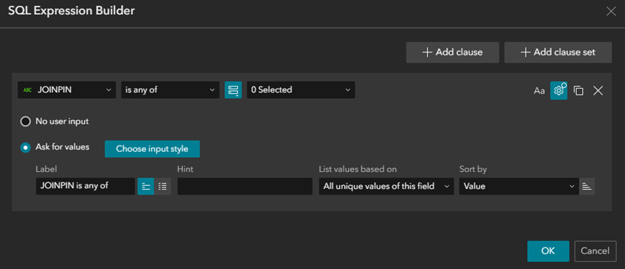

    • Set filter to filter by JOINPIN (see attached image)

  • Randomly select some parcels in the filter to filter layer
  • Previously, this would have updated the ‘filter count’ whereas the ‘unfiltered count’ would have remained the same (see attached image)
