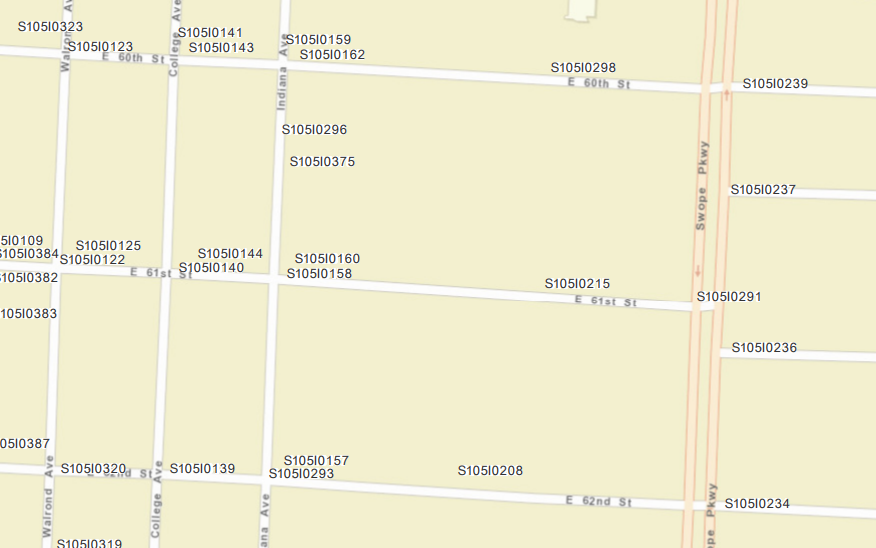

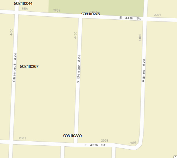

I am having issues printing from the Web Application builder print widget and the ArcGIS Online map viewer print function. Basemap layers will print fine, but features from my feature service are not being displayed in the image/file that is generated for printing.
When I try to print I get the labels from the features displayed, just not the symbols for the features.The feature service is a secured service running on our organization's 10.3.1 ArcGIS Server registered as an item within ArcGIS Online.
I get the same experience whether I use the print service available in ArcGIS Online or a print service running from our ArcGIS Server environment.
Attached is a screenshot generated from a print from the web application builder
And from ArcGIS Online directly:

JohnPlunkett
What are the features in your feature service?
Point/Line/Polygon?
Do they have Z values enabled when you published them?
BrianHiller
They are point features without the Z values enabled.
