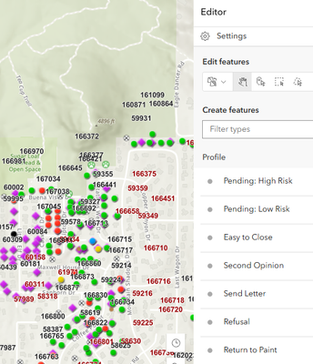

I have a feature layer with unique type symbols.  The symbols display correctly on the map, but are all grey dots in the Editor pane.
This problem applies to AGOL Map Viewer (Editor), Field Maps (Collect button), and Experience Builder (Editor).

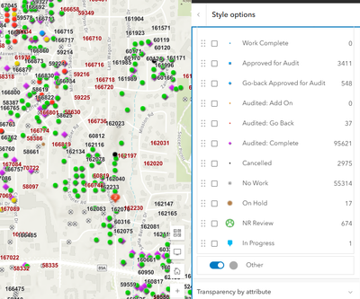

ConorFlynn
This is how the layer symbology is configured:
