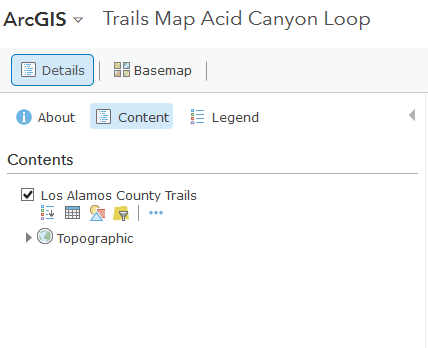

Now I have created an AGO map with them in it, and the features do not draw.  This is the map:
http://arcg.is/0CTeLW

I don't see the five feature services added to the map you linked:

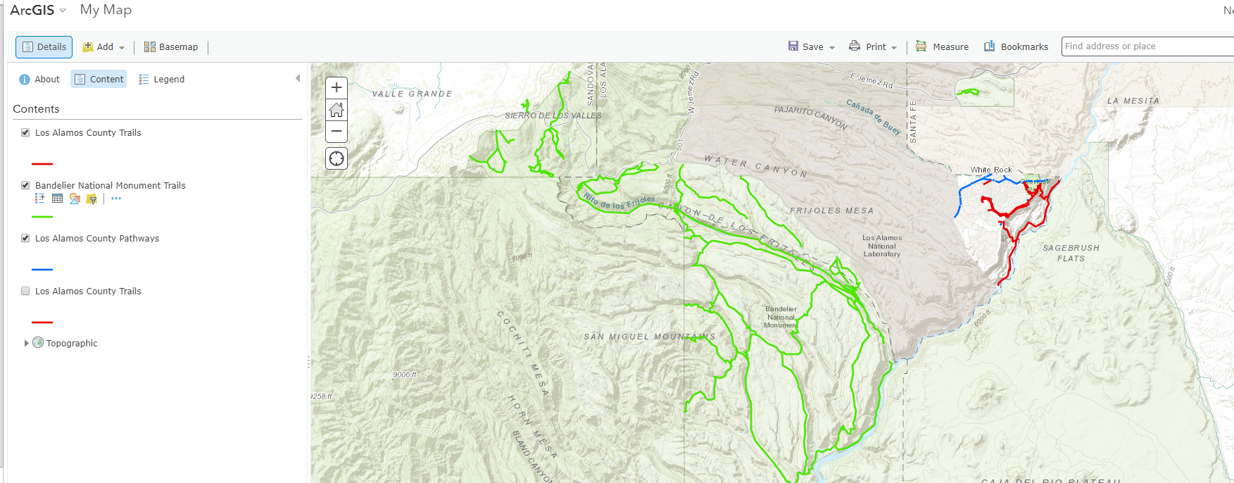

The feature service in the map is a hosted one with no features in it.  I was able to add the first few services from your Server to a new map, though, (the layer that's not visible is the hosted one):
