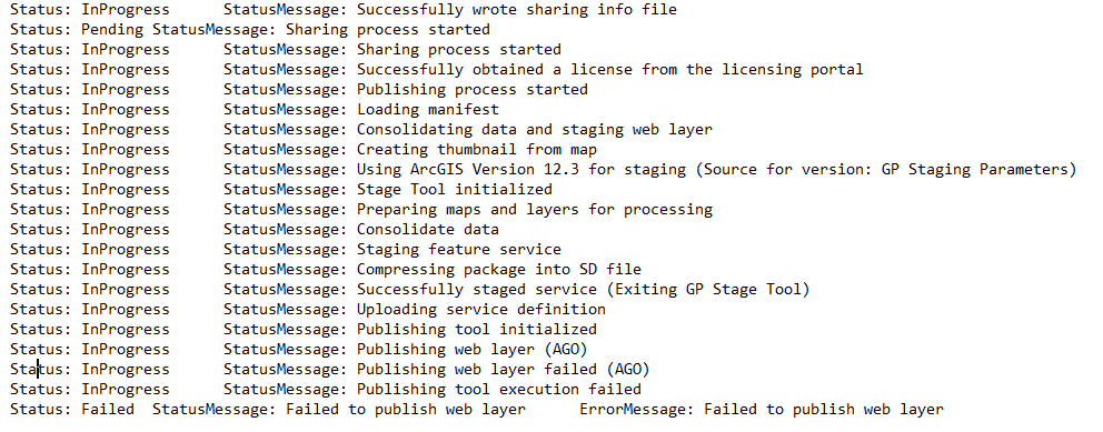

I have been trying to publish a layer to ArcGIS Online but kept failing on multiple ways:
- From arcgis pro (2.4.2)
stuck on "Uploading service definition" and when I stopped the publish, the log shows:
- From arcmap (10.7)
stuck on Server-side post processing...
- From AGOL by uploading csv or shapefile
got the error popup saying: There was an error publishing the service.
The layers are pretty small (about 1k records).
Any thoughts or ways to fix? The service health shows no issues but I am wondering if there is any server side issue.

Rafaelde_Oliveira_Casagrande
Hi Sang,
For troubleshooting the problem, can you create an AGOL Trial account and then publish the data?
Link for Trial
What's the result?
Best,
Rafael Casagrande
SangHyouk_Oum
We just tried publishing the same dataset using trial account and it worked. It's published to services5.
Ok. Probably there is a problem with your organizational account. I suggest you contact Esri Support.
Regards,
Rafael
by Anonymous User
Not applicable
Hello,
I'd also try publishing different data and see if that's successful? That should tell us whether it's the data or ArcGIS Online that has the issue.
Best,
Lauren
SangHyouk_Oum
We tried different data but not luck.
JacobWatson1
Are you storing your layers on your computers local drive or is it being stored somewhere else? I had a problem like this and solved it by migrating all the data I was trying to publish to my local drive.
