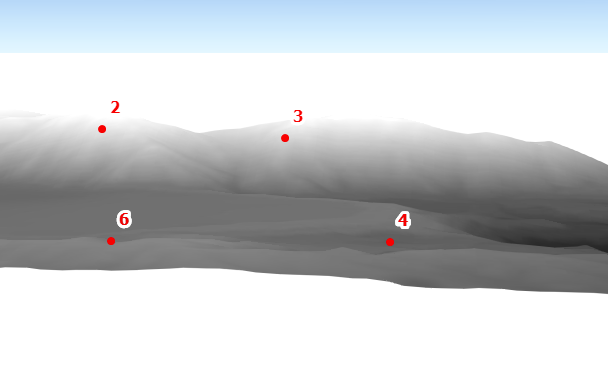

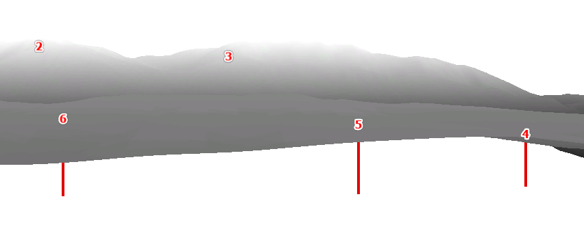

I have created a scene in ArcGIS Pro with a series of points that I created for testing. I extruded them down 1500 feet and ran layer 3d to feature class to get the following effect:
When I share t his as a scene to my arcgis account, I cannot see the lines. I see the surface and the points, but the shafts simply aren't there.
I see the lines in the legend, they are not visible in the scene (also, number 5 disappeared for some reason).
Hoping I'm just missing something simple that someone could set me straight on? Sorry if it's an obvious thing I'm overlooking. I'm just getting started in 3D.

This is a known limitation of the geometry not being OGC compliant.
Problem: Vertical lines are not drawn in ArcGIS Online Scene Viewer
If you use this tool with the OGC standard you will see you will get errors on those veritcal lines.
Check Geometry—Data Management toolbox | Documentation

Is there a workaround? The "workaround" offered seems to just be an explanation of why this doesn't work:
Solution or Workaround
The data store used by ArcGIS Online requires geometry to be OGC-compliant. However, Portal for ArcGIS uses the internal Esri shape format which does not necessarily need to be OGC-compliant. Straight-up vertical lines are not treated as invalid geometry when published to Portal.
RandyMcGregor_Home
I see. The solution is to use Portal, rather than ArcGIS Online. That is not an option. I think I saw someone recommend buffering the points and creating cylinders. I'll try that...
RussRoberts
Esri Notable Contributor
Yup converting the lines/tubes to multipatch and publishing a 3D Object scene layer can work around the issue you are having above.
