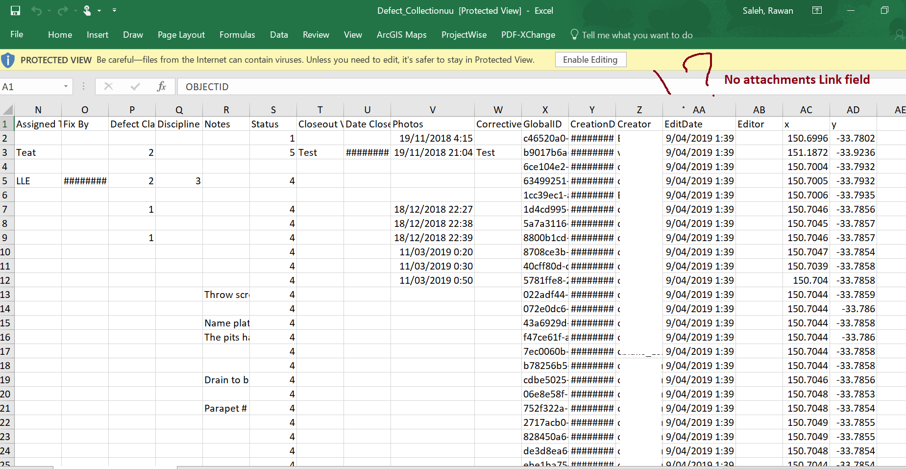

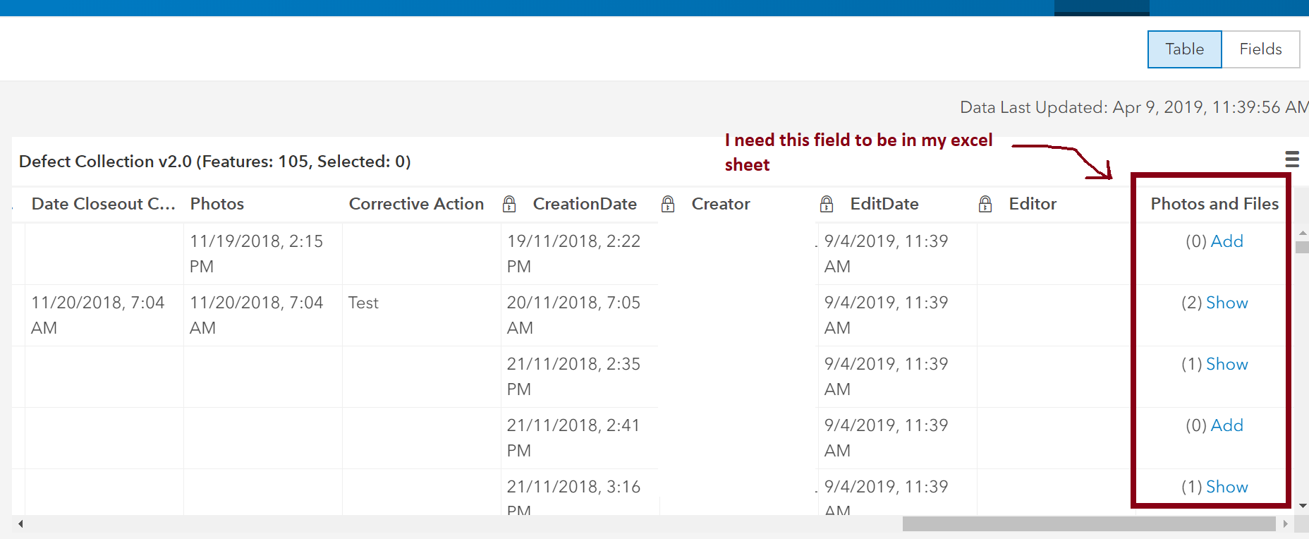

Hi,
I’m wonder if there is a way to let my users export a feature layer with attachment enabled from AGOL to excel sheet with keeping the links filed for the attachment?
Right now when they export a feature layer they don’t have the field for the attachments links.
How could I manage to have this?
Cheers,
Rawan

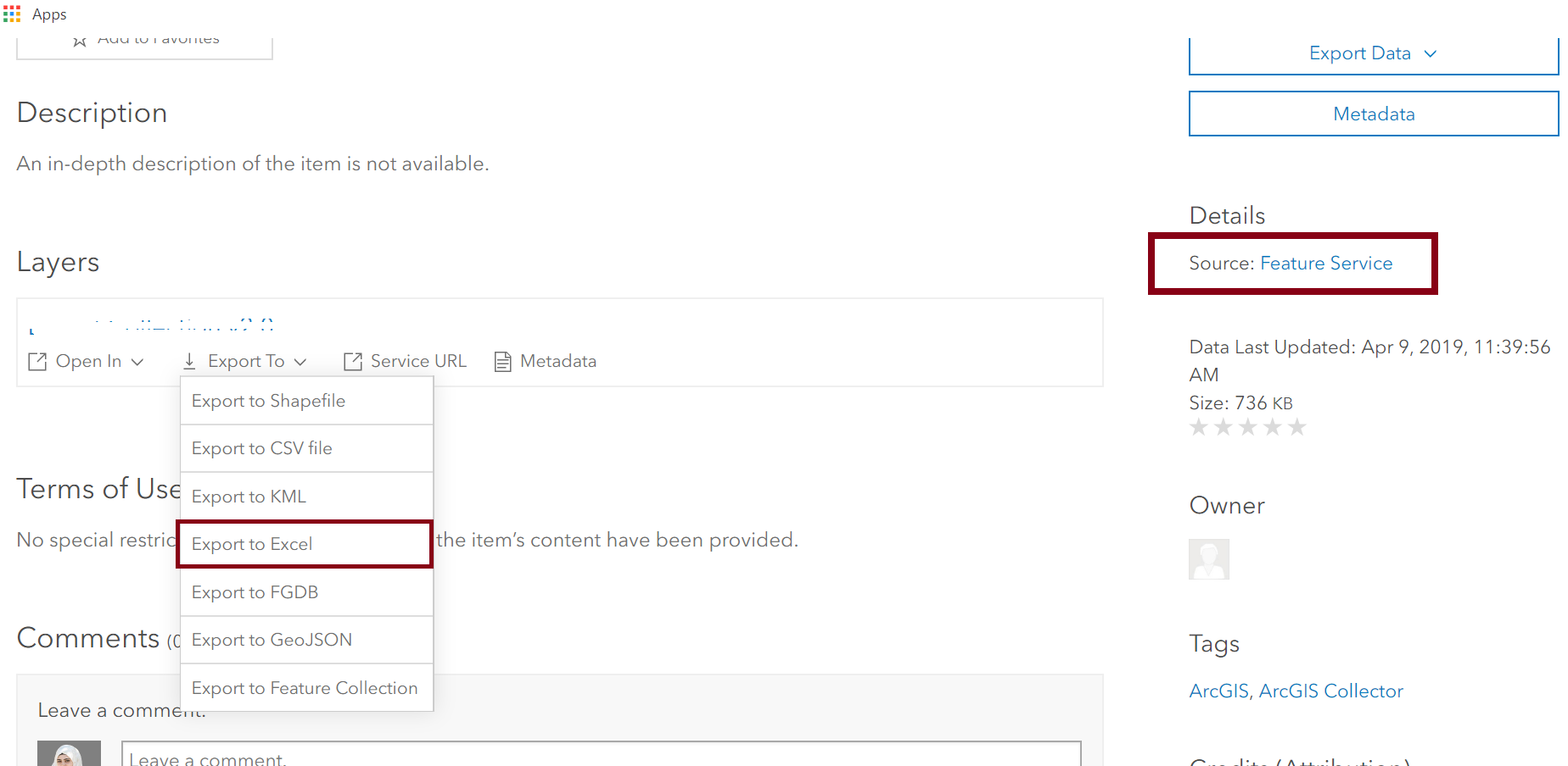

We only support attachments when exporting to filegdb or sqlite. Any other format, you will get only the features.
You can embed a url link (url) to the attachment in the main layer as a field and this will get exported.
