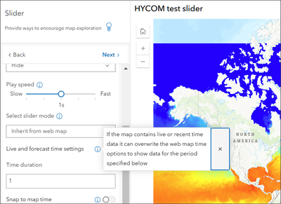

I'm not sure from the info provided where you are trying to view the HYCOM layer but assume that it is via Map Viewer. Map Viewer will "remember" the starting date and range of the layer when you add it, hence the "month behind" you are seeing.
One easy to way to always fetch the data for the current date is to use the Slider Instant App. In Step 2 in Express mode you can toggle Live and forecast time settings on.
