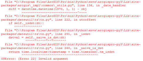

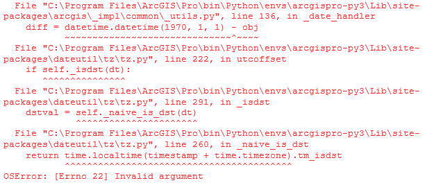

I'm getting the errors shown in the first screenshot below when trying to add features to a hosted feature layer using the Python API.
The features throwing the error all seem to have dates at or prior to 1/1/1900.
When constructing the JSON for the features to add, I'm assigning our local time zone to the datetime object.  Is there a different approach I should be taking to avoid these errors?  The second screenshot shows a sample of the dictionary key and value being used when trying to add features.
If I set any dates at or prior to the year 1900 to NoneType objects, the features are written to the hosted feature layer without errors.
'DateField': datetime.datetime(1900, 1, 1, 12, 0, tzinfo=tzlocal())

mpboyle
Honored Contributor
I'm already handling the dates if they're prior to 1900 (code below).  I'm really wondering why I'm getting an error at all when trying to insert a feature with a date prior to 1900...are these dates not supported by the Python API?
def format_date(input_value):
    if isinstance(input_value, datetime.datetime):
        if input_value.year <= 1900:
            return None
        else:
            return input_value
    else:
        return None

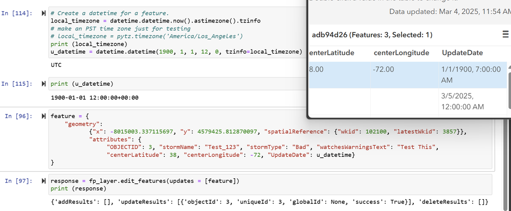

JohnEvans6
Came across this looking for something else doing something similar. I don't know if something that says "works on my machine" is helpful but everything seemed to upload for me doing the following:
Maybe there's something up with tzlocal() not producing a timezone object?
