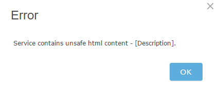

Has anyone else seen this error before?
It appears when I try to publish an editable feature layer from a service URL but I cannot figure out the cause. It is a layer I published earlier from ArcGIS Pro and there is nothing special about it. If I don't find a solution tonight I will put in an Esri Support Ticket and post back here on what I find.

As some follow up, this was caused by the following bug: BUG-000099728. As a workaround, ensure that there is no text in the description field of the Map in ArcGIS Pro when publishing.

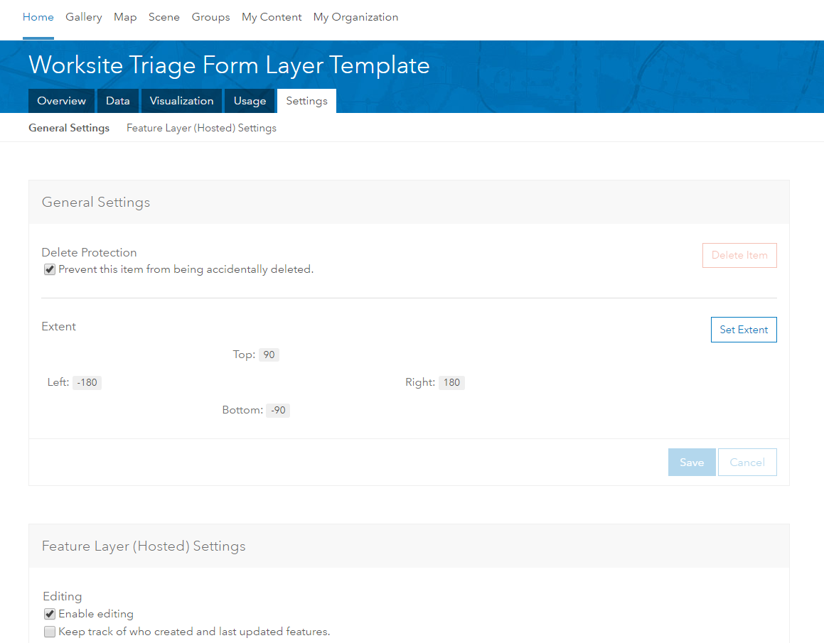

Here are the settings on my end. I am able to use other services with no problem, but it seems to be either because I am publishing from Pro or a setting on the service / item page.
