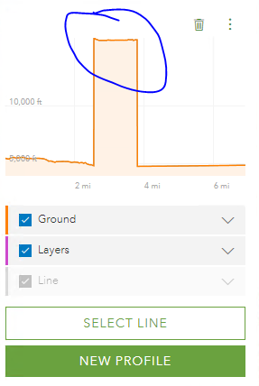

I have published a web elevation layer (from a scene in ArcPro). The units are in feet and are in the 5,000's range. This is a snip from an elevation profile done with the scene viewer. The elevation units are being treated as meters and multiplied by 3.048 to 'convert them' to feet. How do I get the scene viewer to recognize the elevation surface units correctly (or should they be converted to meters)?

Thanks for the input, but that didn't work. See below.  It 'thinks' the custom surface has elevation units of meters so whatever unit I pick the elevation will be modified as if it were starting with meters.

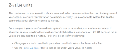

Hi @RandyMcGregor3, ArcGIS Online assumes the 'z value' of your Elevation layer is the same as that of the scene. My assumption is that this scene also contains the default elevation layer, which is in Meters.
To fix this, I think you'd need to either:
  • A) Use Meters: Convert the unit of your elevation surface to Meters using the Raster Calculator tool in ArcGIS Pro
  • B) Use Feet: Re-author the scene as a local scene, using only your elevation layer
Here's the relevant section from the documentation:
Full documentation: Basemap and elevation layers—ArcGIS Pro | Documentation
