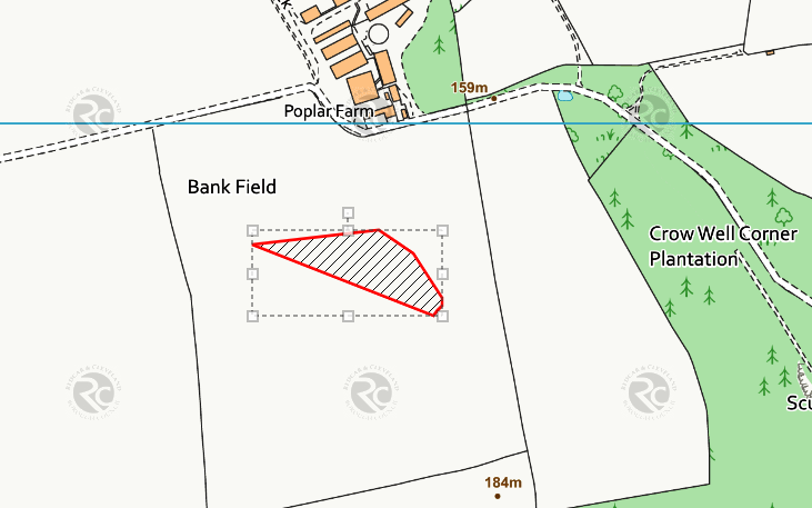

I am setting up a map for a user in my organisation with the end goal being that she will be able to add / delete / edit the polygons of a layer which has been set up to allow editing of the layer through the Web Map. I have set the feature layer to allow editing and when I open the web map I can click "Edit" on the top toolbar and select the later I wish to edit / add to.
I can draw a polygon in the usual way. However, say for example I wished to remove a vertex or fundamentally alter the shape of the Polygon I find I am unable to. I can select the polygon at which point I get a dashed grey box around the full polygon with squares on the corner of this dashed box which allow me to distort / stretch / rotate the polygon but I cannot figure out how I am able to edit / move / delete the individual vertices I have added to create the polygon...
I have found that if I open the feature layer within a map with full editing control, clicking a second time shows all the individual vertices but doing the same thing within a webmap doesnt work the same.
Can individual vertices of a polygon be edited through a Web Map or does this have to be done via editing the feature layer?

BenCochrane
hI Katherine,
This works if I edit the feature layer by "Open in Map Viewer" > "Add to map with full editing control". However opening the web map and clicking on editing allows me to click on the polygon and get the grey dashed box but clicking again does not show individual vertices.

@Katie_Clark definitely an old thread here, but I wanted to point out that I read that also. It is written incorrectly so it took reading through this thread to figure out how to actually edit the vertices in AGOL. It's not a "double-click", it is a click, then another click. So - a slow 2 clicks. If you double-click you just get the dashed grey line like original post showed and all I was getting. And I like how ESRI is saying that it's rare. When do they otherwise interject their opinions into GIS workflows!? So weird. Needs to be re-written.
So I click on my feature, click edit in the pop up window, then click the feature again and close the pop-up window to get this:
The other part that's weird about this is the cursor stays a pointing hand so you use the pointing hand to click and drag each vertex. That seems very odd. Hope this helps other people. Thanks for the post @BenCochrane!

BenCochrane
HI Katherine,
Yes I have full editing controls selected as can be seen below ..
Within the Web Map, I  can click on Edit > Add Features and create a new polygon I just cannot activate my plotted polygon to show me all the vertices, double clicking the newly created polygon does not show all the individual vertices in the web map view, it does however work if I open the feature layer > Open In Map Viewer > Add to new map with full editing control.

JuliaZorn
I just had this same problem. In order to get the vertices to show up I had to turn off two of my layers. Both of those layers overlapped (at least in part) the polygon that I was trying to edit. I'd recommend turning off (unchecking in the Contents) various layers that might be overlapping or sharing space with your polygon layer.
FCCStrategicPlanningAdmin
Thank you very much. I was having the same issue and resolved it by turning off other backgrounds layers
