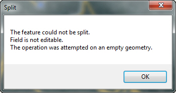

I have a feature service layer consisting of a point feature and line feature. these are generated via Collector. I need to perform some cleanup of the line data, specifically splitting some lines while maintaining editor tracking and global ID.
I have created a local copy for editing within ArcMap and need to split the lines. However, when trying to split, I get an error window:
Split Tool Error
I copied and pasted the line layer and was able to split those lines, but not the existing feature service layer. I also tried to complete the process that way, but I lose the editor tracking information as well as the GlobalID. Is there a workaround or can someone point me in the right direction?

Hi Kelly,
Yes, I am creating a local copy. I am hoping to create a multi part feature, so I'm splitting the line in multiple parts.
I did find a work around however. I was attempting to use the Split Line on the editor tool bar, which was giving me the error. However, using the Split Line feature from the Editor drop down menu allows me to select to split the line in to "X" number of equal segments. With the editor tracking, I need to maintain original creator and date info. Once I perform my cleanup, I merge the existing lines back into the original feature, which has preserved the Editor tracking info I need.

Thanks for the update. In order to change the service type into multi-part features, the geometry of the service would need to be mutli-part. This isn't usually a default geometry type in ArcGIS Online and must be set on service creation. Thanks for sharing how you solved the problem.
