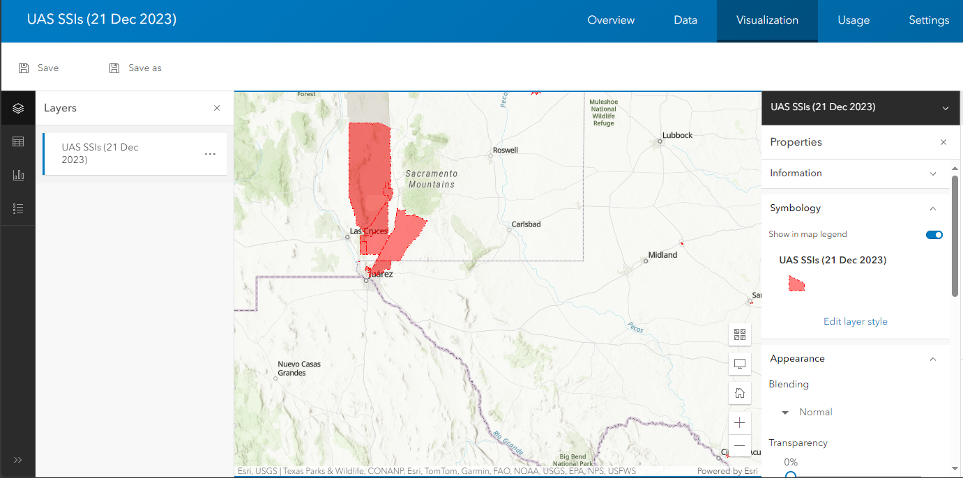

  • Through the Viz tool, update the fill and outline of the hosted feature layer from blue to redAGOL_Style_applied.PNG

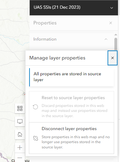

  • Under Properties -> Information, save the changes. On exploration, there are only options to "use styling as it was published" or "Use map properties". Either option will not change the drawingInfo.

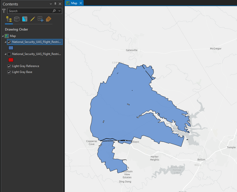

Now in ArcGIS Pro, sign into your portal and load this map through the Catalog -> Portal. The style does load into Pro this way.
Now load it through Add Data -> Data from Path. Load the yourendpoint/FeatureServer/0/ URL. The styling is the base styling and not the styling applied/saved to the layer via the viz tool. If you go to the drawingInfo, the info remains as it was published.

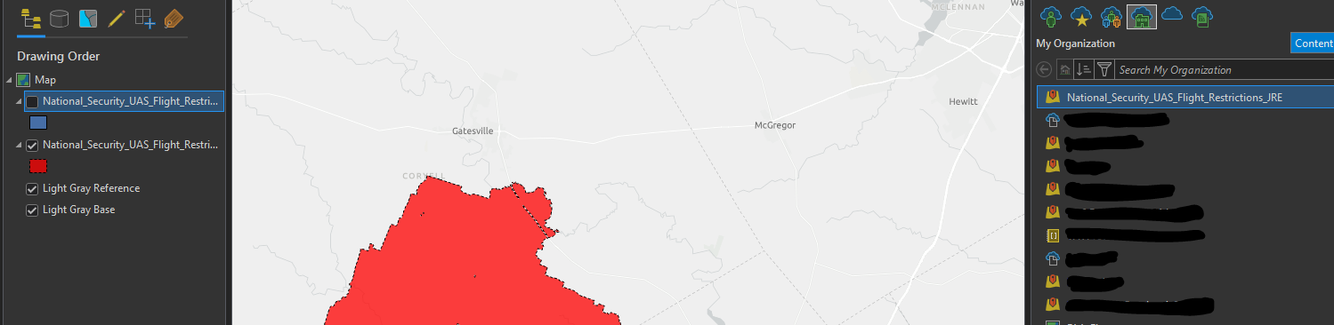

Here is a map adding the REST URL (I have already created a new item from it and modified the symbology in the visualization tab, but the URL with have the original symbology):
Then, if I load the 'item' that I modified the symbology in the visualization tab:
R_

Below is our application loading the endpoint as blue. In AGOL this layer has been visually updated and saved to be Red. It will display Red in an AGOL map and in ArcGIS Pro if loaded from the content pane. If i load this layer via URL, it is blue.
