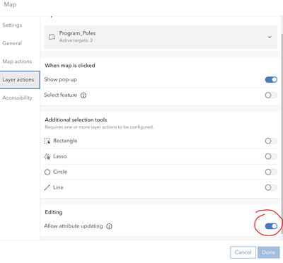

DionysiosKerasidis1
You can also edit, if edit in enable in the map setting within the dashboard.
