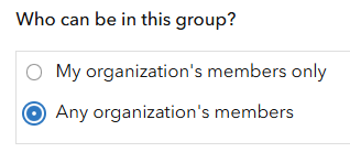

1. Create a Group, and allow users from other orgs to be a part of that group. Share the map and layer(s) to the group.
