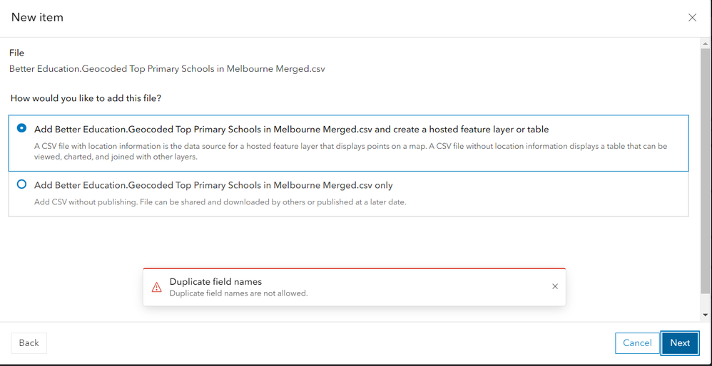

In order to add this csv item to ArcGIS Online hosted feature layer, I deleted all other feature layers. However, even there has already no layer, the system still display the duplicate filed names error.
JRhodes
You have two columns named "Total Enrolments_P". (Column F and Column AB).

JRhodes
ECjin
Thank you! I went as far as using the ChatGPT Code Interpreter to assess my work, and it didn't flag any issues lol. You spot it! Thanks again!
