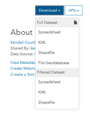

Another option to get downloads to work for all users without repeatedly creating standalone files is to use Hub. Through a Hub site, the download links directly prepare a file for the user. That way the data will be current up to the moment the file is generated, and you can tell users / members of the public to refer to your Hub page for all data download requests.
