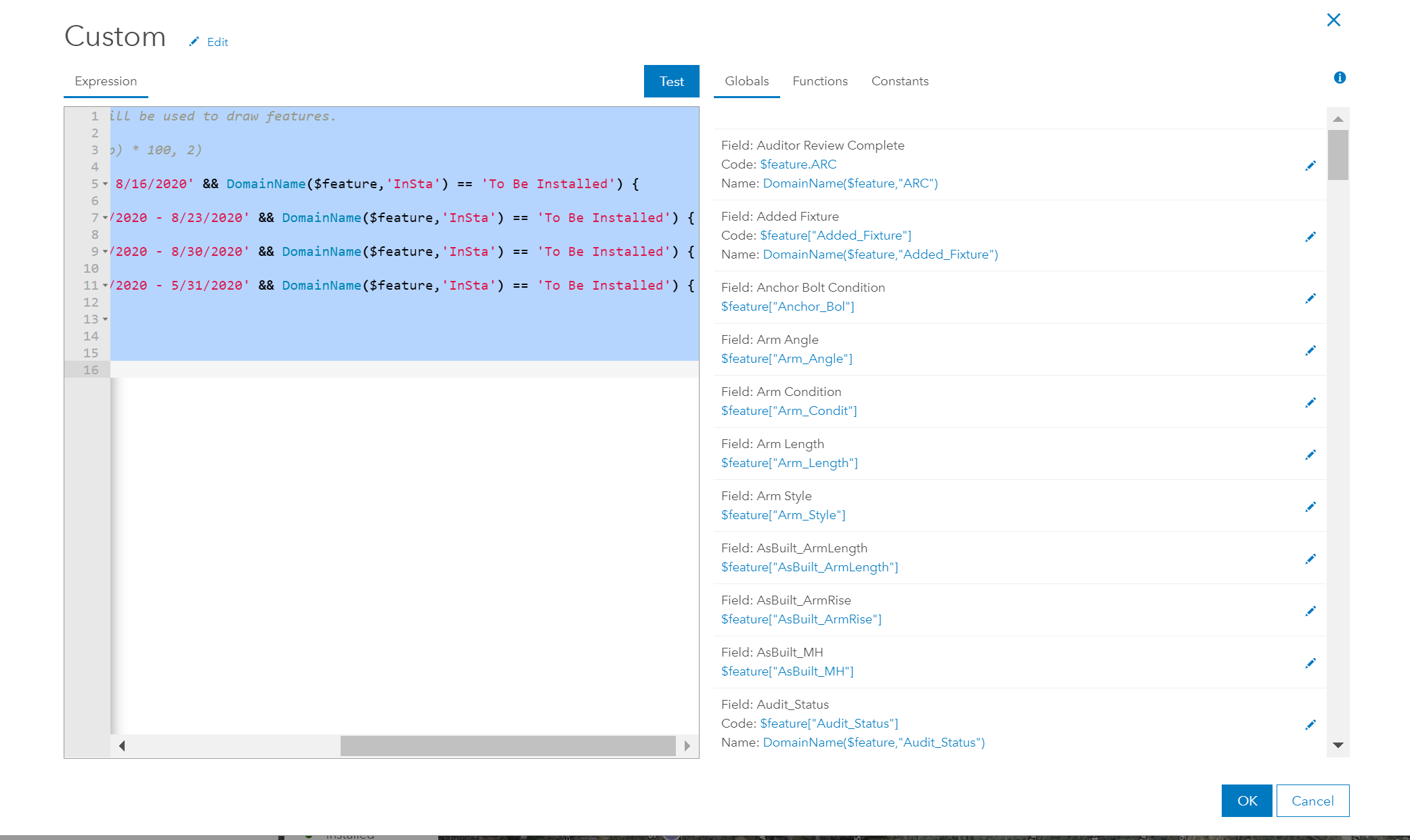

NWEdisonTeam
1. That code was wrong I mis-copied so apologies
2. I got it to work by changing the structure and just doing a bunch of else if clauses. See the screen shots below:
I was overly complicating it
