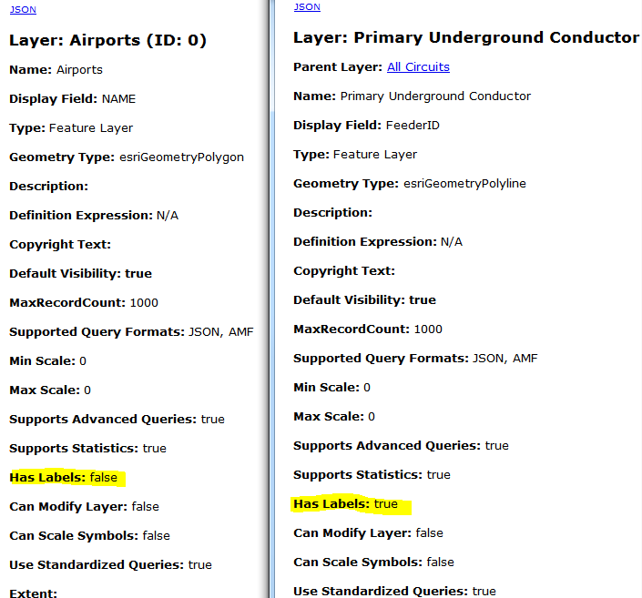

I found no issues with this data as I can see all of the descriptive fields. I compared the two layers and the only difference I found was the following:
I shared the service again with my problem layers, this time without any labels and it worked!! Seems odd that the labeling was the issue. Thank you so much Jake!
