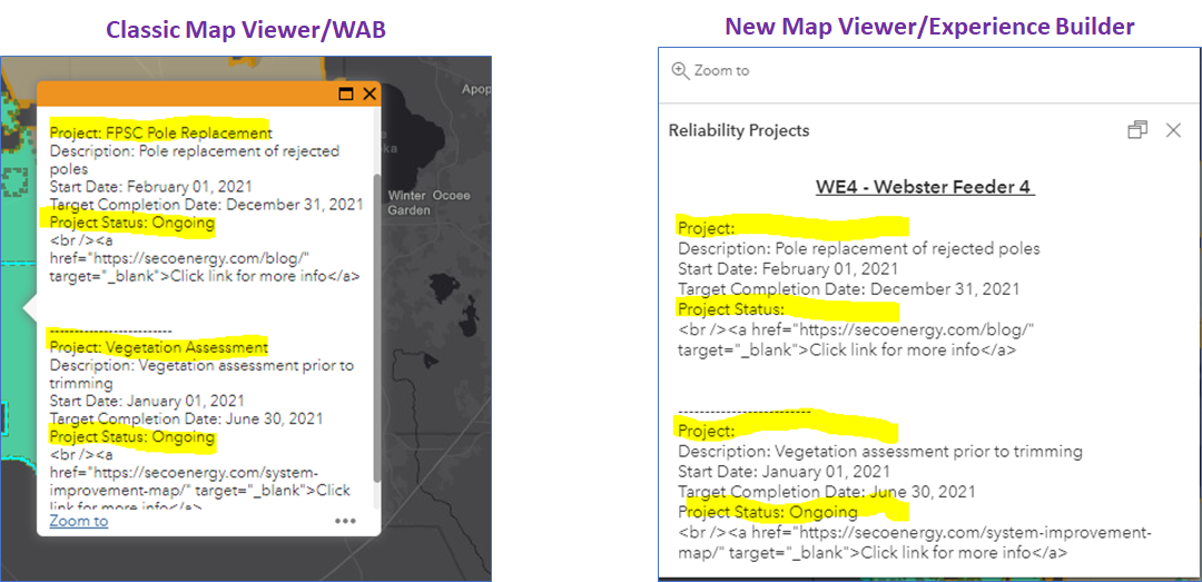

Is there a glitch in displaying domain names in the "New Map Viewer" and "Experience Builder"?

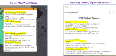

I have the script below for my pop-up, it displays correctly when the map is viewed in the "Classic Map Viewer" and WebAppBuilder, but when viewed in the "New Map Viewer" and "Experience Builder" the domain name becomes blank (see screenshot of popup comparison at the end of the post)? The pop-up is also previewed correctly when tested on the custom pop-up expression window.

var project_1 = 'Project: ' + DomainName($feature,"WORK_TYPE_1") + TextFormatting.NewLine + 'Description: ' + $feature["PROJ_DESC_1"] + TextFormatting.NewLine + 'Start Date: ' + Text ($feature["PROJ_START_1"], 'MMMM DD, YYYY') + TextFormatting.NewLine + 'Target Completion Date: ' + Text ($feature["PROJ_END_1"], 'MMMM DD, YYYY') + TextFormatting.NewLine + 'Project Status: ' + DomainName($feature,"WORK_STATUS_1") + TextFormatting.NewLine + '<br /><a href="' + $feature["HYPERLINK_1"] + '" target="_blank">Click link for more info</a>'
var project_2 = TextFormatting.NewLine + TextFormatting.NewLine + TextFormatting.NewLine + '------------------------------------------'+ TextFormatting.NewLine + 'Project: ' + DomainName($feature,"WORK_TYPE_2") + TextFormatting.NewLine + 'Description: ' + $feature["PROJ_DESC_2"] + TextFormatting.NewLine + 'Start Date: ' + Text ($feature["PROJ_START_2"], 'MMMM DD, YYYY') + TextFormatting.NewLine + 'Target Completion Date: ' + Text ($feature["PROJ_END_2"], 'MMMM DD, YYYY') + TextFormatting.NewLine + 'Project Status: ' + DomainName($feature,"WORK_STATUS_2") + TextFormatting.NewLine + '<br /><a href="' + $feature["HYPERLINK_2"] + '" target="_blank">Click link for more info</a>'
var project_3 = TextFormatting.NewLine + TextFormatting.NewLine + TextFormatting.NewLine + '------------------------------------------' + TextFormatting.NewLine + 'Project: ' + DomainName($feature,"WORK_TYPE_3") + TextFormatting.NewLine + 'Description: ' + $feature["PROJ_DESC_3"] + TextFormatting.NewLine + 'Start Date: ' + Text ($feature["PROJ_START_3"], 'MMMM DD, YYYY') + TextFormatting.NewLine + 'Target Completion Date: ' + Text ($feature["PROJ_END_3"], 'MMMM DD, YYYY') + TextFormatting.NewLine + 'Project Status: ' + DomainName($feature,"WORK_STATUS_3") + TextFormatting.NewLine + '<br /><a href="' + $feature["HYPERLINK_3"] + '" target="_blank">Click link for more info</a>'
var project_2_extra = IIf(($feature["WORK_STATUS_2"] == 'planned' || $feature["WORK_STATUS_2"] == 'ongoing'), project_2, '')
var project_3_extra = IIf(($feature["WORK_STATUS_3"] == 'planned' || $feature["WORK_STATUS_3"] == 'ongoing'), project_3, '')
var popup_info = project_1 + project_2_extra + project_3_extra
Return popup_info

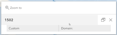

Nothing is returned using the domain
return "Domain: " + DomainName($feature,"FishStatus") + TextFormatting.NewLine
       //+ "Value: " + $feature.FishStatus;

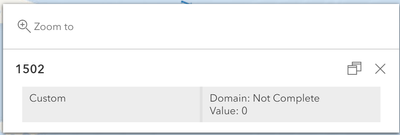

 If I add in the actual value, then the Domain value shows up:
